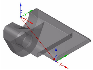

The Dynamic Plane dialog box displays and the dynamic gnomon appears in the graphics window at the current view origin.
6.  The next step is to reposition the view origin. Click once on the ball that represents the gnomon’s origin and then drag it to the left end of the front edge of the part.
TIP: Use the AutoCursor position
indicator to make sure you select the
endpoint of the line.
7.  Click on the second leg of the Y axis (the piece between the arrowhead and the letter Y ) and rotate it 90 degrees to point towards the back of the part.
8.  Click again to set the Y axis position.
9.  In the Dynamic Plane dialog box, type MY VIEW as the name of the new view.
10.  Select Set as WCS to change the WCS to the new view.
